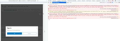

@AbbyE_Esri -  First of all, thank you for the help and the compliment on the StoryMap!  That's odd that you aren't seeing the prompt....as we still are and have tried on multiple computers and in incognito mode.  Here is a screenshot of the 'inspect' tool when getting the error this morning.  I don't know if it would matter, but were you signing into your ESRI account when viewing the SM and perhaps your authorization/license and sign in didn't trigger this prompt?  We're really stumped!
