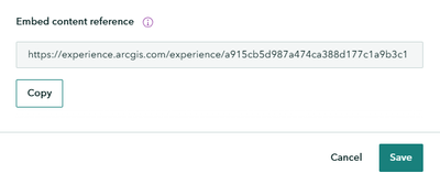

@OwenGeo I have just run into a similar problem. I have an Experience Builder app (https://experience.arcgis.com/experience/a915cb5d987a474ca388d177c1a9b3c1/) with multiple pages for different organizations' data.  I would like to embed each page individually into a series of storymaps customized for each organization, but when I paste the long URL with the page name into the StoryMap, it truncates it to just the parent URL. So for example,  https://experience.arcgis.com/experience/a915cb5d987a474ca388d177c1a9b3c1/page/Hallowell-Conservatio... defaults to the home page, https://experience.arcgis.com/experience/a915cb5d987a474ca388d177c1a9b3c1
See the screenshots below. The first shows the full URL that I pasted into the web content box. The second shows the resulting truncated URL after completing the embed step.

@SchaffnerBecky - This appears to be a different issue. We are looking into it and will see if we can address it in our next release in late January 2026.
Owen Evans
OwenGeo
Esri Notable Contributor
@SchaffnerBecky - The issue you ran into with Experience Builder URLs was fixed in an update to ArcGIS StoryMaps last night. Please try again and let us know if you are still having an issue.
Owen Evans
SchaffnerBecky
Yes, it does appear to be working for us now. Thank you!
