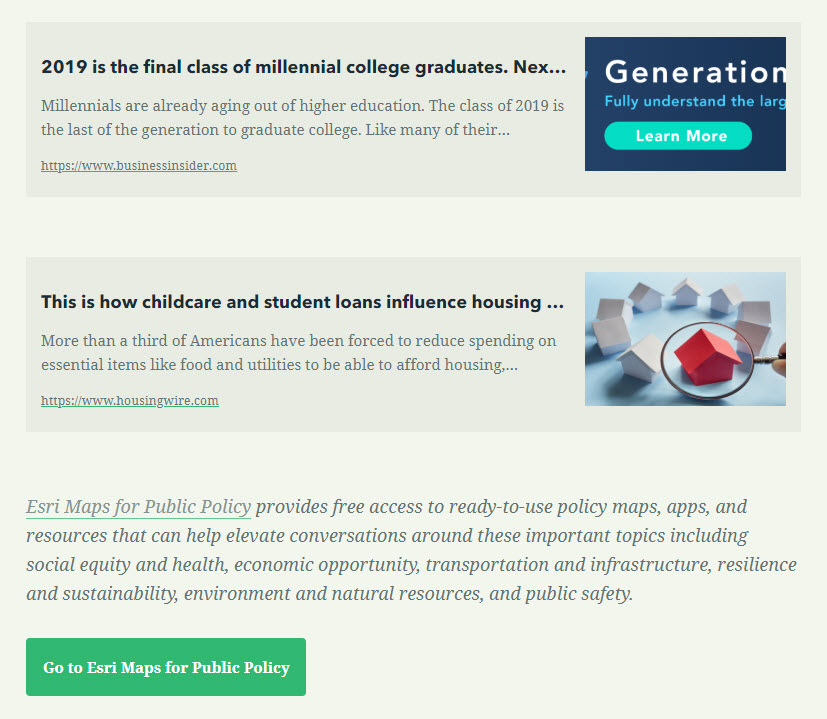

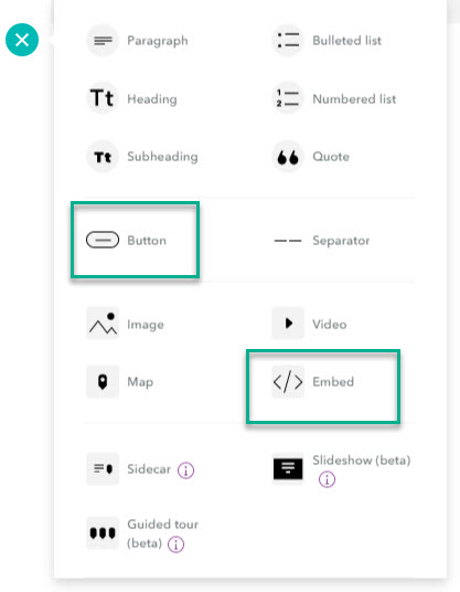

Embed Cards and Buttons
When adding context and explanatory text around your maps, it’s very common to link to various sites and documents. In addition to adding a link within paragraph text, there are two other options you might like: embed cards and buttons.

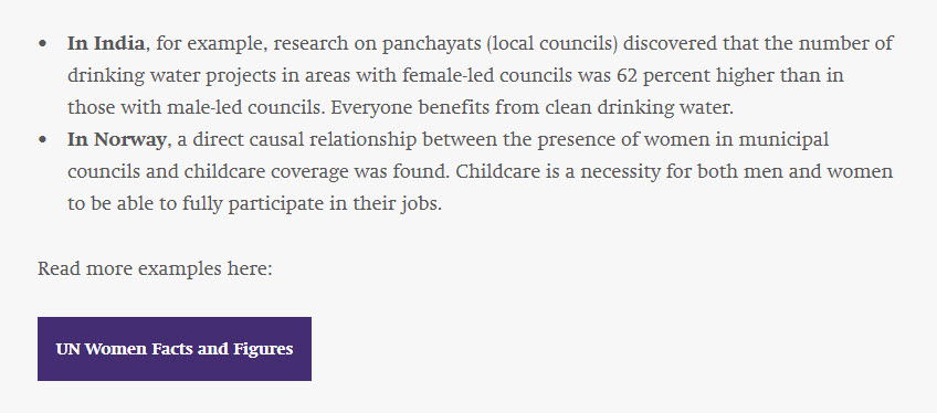

Embed cards are great when you really want to highlight the source, document, or website that you’re linking to. They take advantage of the website’s metadata and display the site’s description and image, although you can still edit within the story. Buttons are a great way to call attention to a link while still maintaining the color scheme of your story.
Here’s an example that uses embed cards for related links, and then ends with a button taking the reader to Esri Maps for Public Policy to explore more maps on the topic at hand:
And here’s an example of using a button to call out a source in a more impactful way than simply linking to it within the paragraph text:

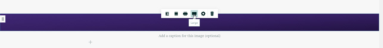

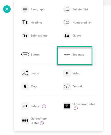

Separators and Horizontal Color Blocks
Use separators straight from the StoryMap builder to add a subtle break in between different sections of your story. The exact look of the separator will vary based on the theme you have chosen.
If you want a more obvious break between sections, one trick is to add a long, horizontal color block as an image. I sometimes create a single-color rectangle shape in PowerPoint, the length of a typical slide. If you want to get fancy, you can play around with shadows and gradient effects. Save the color block as a .png image, and add it in to my story. If your image is over 1920 pixels in width, you will see an option to add it in as a “large” image:

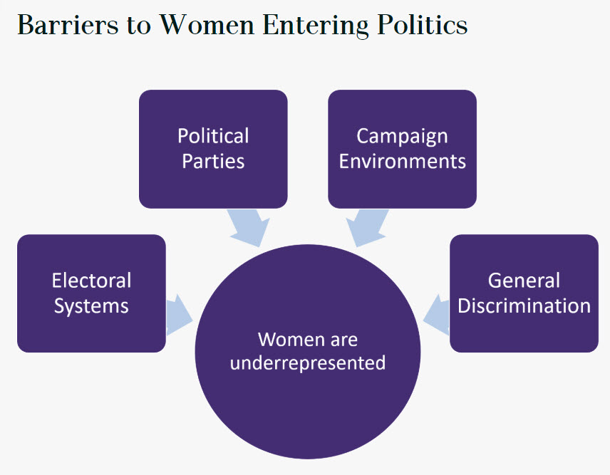

Conceptual Diagrams
Can you represent what your text is discussing in some kind of visual diagram? These often make a great graphic for your story map. Here’s an example in which I combined multiple icons to create a visual representation of my topic:
Here’s an example of taking advantage of PowerPoint’s SmartArt, which provides lots of templates for flowcharts, processes, and relationships. I then go on to discuss all four of these concepts in detail in four different paragraphs underneath this diagram within my story.
