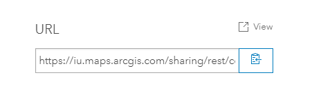

@OwenGeo For all embedded PDFs, I'm using the links that are generated at the bottom of the PDF Overview pages, after changing their permissions sharing to public (see attached screenshot)
