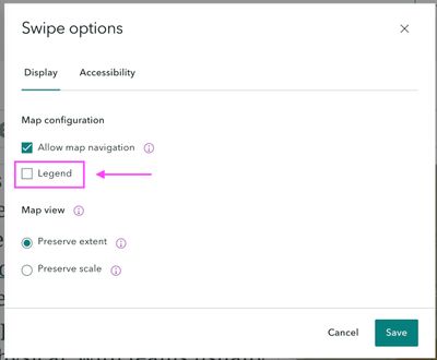

Having a layer list panel is on our list, but it hasn't been added to the roadmap at this time. It would be helpful to have an idea on the Ideas Board to track interest this request; I don't believe there is one yet.
Legends have been available for the swipe block for quite a while in the swipe options (gear menu).
