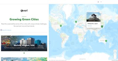

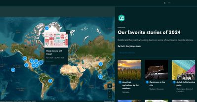

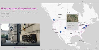

@iperiod - Thanks for sharing what you are looking to create. I have to say that this really does sound like a perfect project for a collection!
Once you create your story chapters you'd add them to a collection. The collection cover can have a title and there are a few areas you can add introductory text or a description. You can also add a map to the cover page (in the Design panel). Then, you can set locations on the map for each chapter of your story. In the map settings, you can pull in your own web map if there are specific layers you'd like to show (like the boundaries of each region). Clicking each location on the map brings up a pop-up that will launch you into each chapter.
You can also change the appearance of the collection (and the stories within it) by using one of the many themes that are available or by creating your own custom theme by configuring whatever fonts, colors, and other styles you like.
Here's are a few examples:
