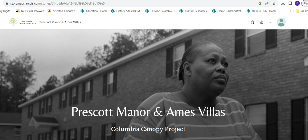

Hello,
I'm writing to see if there's any way to enlarge the logo and title banner at the top of every StoryMap. As you can see in the attached image, the logo and title banner (Columbia Canopy Project green logo and "Prescott Manor & Ames Villas" title) appear in the top left before a white background. They are very small.
Thank you,

@KatharineAllen - Thanks for posting this question! The header is a small space by design because we don't want it to take too much screen real estate away from your story, so there isn't currently a way to make the logo bigger. We typically recommend using a logo without small text elements. A logo where the text is as tall as the logo height can work, but logos with smaller text elements typically don't work well.
However, we have some enhancements in progress that might address your concern about having such a small logo! We are planning to add the ability for you to add your logo to the main area of the cover page and hope to make this feature available by the end of this year, so you shouldn't have too long to wait to try this out.

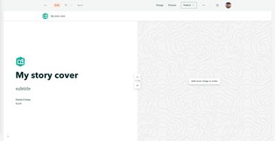

@MichaelFeerer - There isn't a setting to increase the logo size in the header, but you can choose to show the logo on the cover, which is a larger size. These options are in the Design panel.
If you want more flexibility to style elements in your story, you can look into the relatively new advanced embedding feature that lets you customize anything in the story using HTML, CSS, and JavaScript code when you embed a story in your own web page. For more info, see Introducing Story Embeds via Script!
