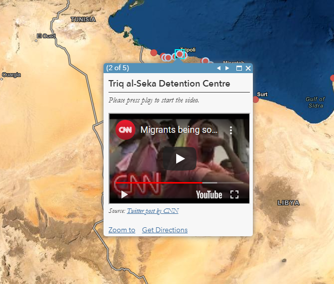

Below is a screenshot of what is happening in the web map:
Pop-Up from Web MapPop-Up from Web Map

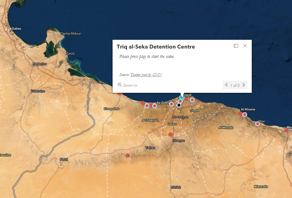

And this is from the story map:
Pop-Up from Story MapPop-Up from Story Map

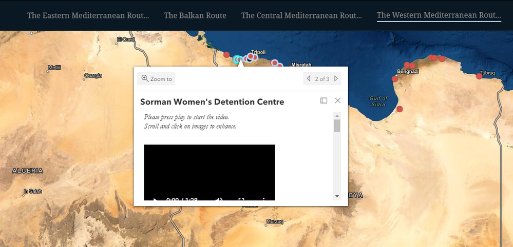

I am referencing some other video content, however it is coming from a different source, and it is displaying flawlessly as you can see from the links above and in the screenshot below:
Web map:
Web MapWeb Map
Story Map:
For this I was able to direct link to this source with simple html tags:
<video controls="" height="180" width="281"><source src="https://media.msf.org/AssetLink/d2h2m7dxb8i3uk1me47647378643arq6.mp4" type="video/mp4"></source></video>

@DruSexton1 -- If you view your web map in the new map viewer (rather than the classic map viewer) you'll see the same issue you see in your StoryMap. Here's a link to view your map in the new map viewer.
Figure: 22 Libyan Detention Centres (arcgis.com)
ArcGIS StoryMaps, the new map viewer, and many other ArcGIS apps (like the new Dashboards, Experience Builder, etc.) are built with the latest (4.x) version of The ArcGIS API for JavaScript, while the classic map viewer is build with the older 3.x version. Although the 4.x version is more modern in every way, there are still some differences between the two and a few things that the 4.x version still does not support. This is an issue with the JSAPI 4.x not supporting some things that the 3.x JSAPI did.
Since this issue is not something we can address on the StoryMaps side, I would suggest contacting Esri Support and reporting the issue you are observing as a bug in the new map viewer/JSAPI. That is the best way to get an issue addressed so that your map works in all the latest ArcGIS apps that are built on 4.x.
