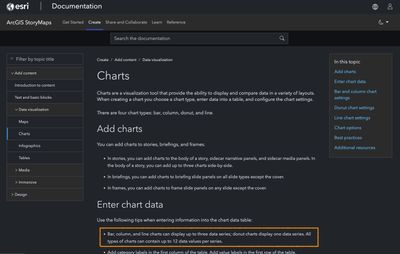

@SteveCole - Thank you for the feedback. I'm sorry you had such trouble tracking this information down. As it happens, we are currently in the middle of a complete re-write of our documentation. We've already released much of this work (you can read more about it here), and the next batch of updates to go out will be the topics covering each content block.
I've attached a screenshot of a portion of the new topic on charts running on our internal dev system. As you can see, we plan to add information about how many rows and columns of data are supported (see orange box), in addition to a lot of other information about charts and all the other types of content blocks.
This should be released sometime in the next few weeks. I'm sorry this info wasn't available when you were looking for it, but we are working to improve our documentation.
Please let us know if you have more feedback about what you'd like to see in the ArcGIS StoryMaps doc.

Clearly not the answer I was hoping for but that is the way it goes. Thank you for finally clarifying that.
OwenGeo
Esri Notable Contributor
Charts are still relatively new, so they remain focused on simple scenarios and small datasets. But we are looking at ways to expand this feature in the future, which may include bringing in charts you've already created in the map viewer (be sure to vote for this idea if you're interested in that) or possibly creating new charts in the story builder from feature layers.
