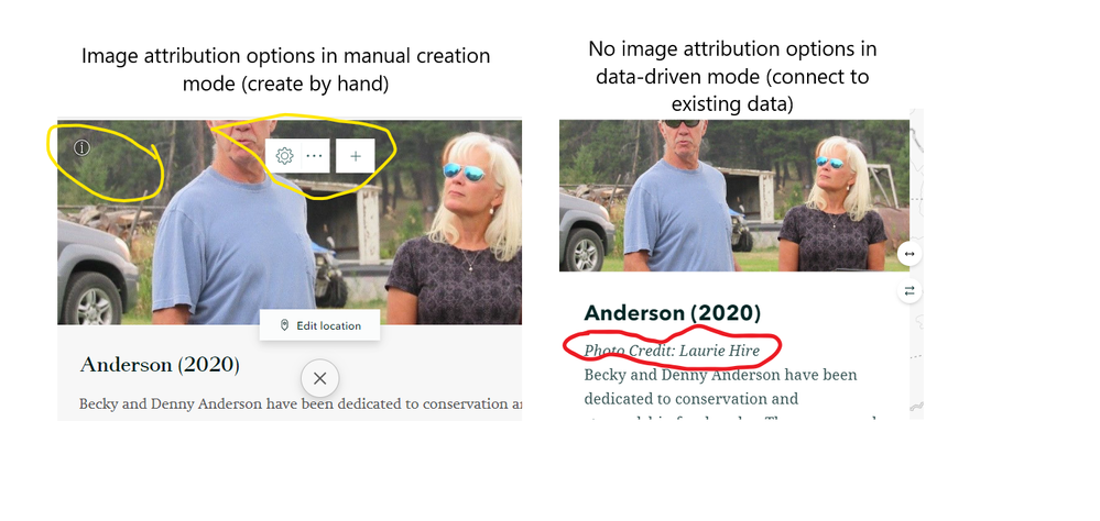

I recently migrated a story map developed using the classic "Shortlist" template to the new (2nd generation) story map service using the Map Tour immersive block. I was really impressed with how stable and clean the new builder was. Afterwards, I found this tutorial for creating the map tour by pointing to an exhisting hosted point feature service that has the images included as attachments. When I tested it, it worked after some troubleshooting with Esri, but I noticed that the same options for photo attribution and alternate text were not available.
Illustration of image options available in data-driven and manual creation map tour workflows.Illustration of image options available in data-driven and manual creation map tour workflows.
I think having the photo attribution available in the data-driven map tour is an important feature because I believe it is implemented in a cleaner way than including the photo attribution in the main content window. I think having the alternate text option is also important for promoting the accessibility of the story map. Please consider adding these features to the data-driven story map workflow.

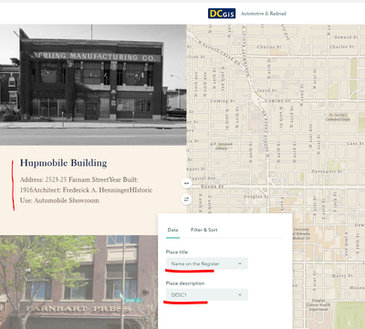

We would like to built a new Story map of Historic landmarks, using new guided map tour. I have an existing service and would like to use it, vs manually entering data. But I discovered that with the existing feature service I cannot add or format the text the way I like. There is only an option to add title and description. And no option for formatting at all.
I also tried to field calculate all the information that I need into one field  (tried both Arcade, and html) so I can get formatting that i need (new line, bold text, etc) but the story map is not honoring html/arcade formatting from the calculated field.  (see image below, data calculated in field DESC1 and shown in guided map tour screenshot).
