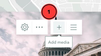

If you are looking to be able to change the media to something else, tours already support adding up to five pieces of media for each place. The media can be any combination of images and videos. Just click the "Add media" button to add more media items.
