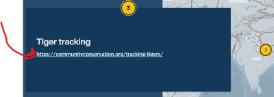

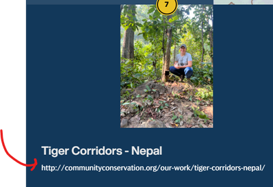

I have a created a Map Tour from a hosted point feature layer that displays various locations, each containing a field with a hyperlink. These links are intended to be associated with individual locations on the map. When attempting to create a Map Tour from the feature layer, the hyperlinks appear as plain text and are not clickable. Alternatively if I use the "Start from scratch" option where points and hyperlinks are added manually, instead of the "From Feature Layer" option, the links can be made live. However this approach would not be feasible for feature layers with many points, and even with fewer points the process is tedious.
