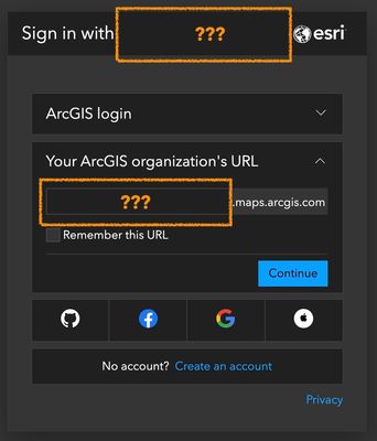

When you share a StoryMap, there isn't anything about the link that lets the recipient know which organization the story belongs to. Readers are sent to a generic ArcGIS login page (shown below), and while this is just fine most of the time, it can be confusing in some situations.
This generic page does not indicate the organization name, and, if the organization uses enterprise logins, the reader needs to know—and manually enter—a portion of the organization's URL.

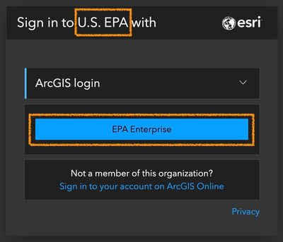

When the URL parameter is provided in the story link, the reader is directed to the organization's sign-in page (not a generic one), which is clearly labeled with the organization name (see example below) and doesn't require the reader to complete the organization's URL. If the organization is configured to use only enterprise logins, readers will be immediately redirected to the organization's login provider's page.
