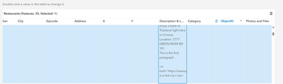

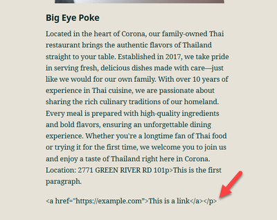

I'm working on a story map that uses the Map Tour block with the Grid layout, and I've run into a snag when trying to include hyperlinks in the place descriptions. I added a new field in my feature layer to hold: <p>This is the first paragraph.</p><p><a href="https://example.com”>This is a link</a></p>
 However, when the tour displays, it just shows the HTML example instead of rendering as a clickable link. Is this a limitation of the Grid layout? Or am I missing a step in how to enable HTML formatting for these descriptions? Any insight or workarounds would be much appreciated.

@MayraHernandez -- It looks like you are using curly quotes inside your <a> tag. Be sure to always use straight quotes inside your HTML.
It also looks like there is an error in your screenshot where you have a partial <p> tag.
Hopefully addressing those items will get this to work as you expect.
MayraHernandez
Ah, good catch, thanks for pointing that out! I actually copy pasted the HTML from the example given under "Anatomy of a description field", so I didn't notice the curly quotes. I switched them out for straight quotes, and it worked!
