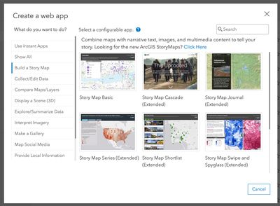

What's happening?
After the December 7th update to ArcGIS Online, you will no longer see the classic storytelling templates in the Create a web app gallery. In other words, the Build a Story Map category and the templates within it will not be available.

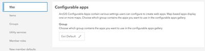

How do I configure a custom template gallery?
As mentioned above, using a custom template gallery will change the experience for all organization members and require that your organization manually maintains this group.
If you are sure you want to do this, the process is similar to creating a custom basemap group, but with the following differences:
  • Instead of adding basemap items to the group, you add the app template items you organization needs. The classic template items can be found in the group referenced above. You should also add any other template items your organization needs by searching ArcGIS Online.
  • Also, your admin would configure the group in the Map > Configurable apps section of the organizational settings (shown below).
For more information about this organizational setting, see Configure map—ArcGIS Online Help | Documentation.
