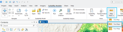

2. Use the Two Maps view
The Two Maps view allows you to compare a criterion map and a suitability map side-by-side.
When you launch the Two Maps view, a second map frame is created that contains the Suitability Modeler group layer.
You can then turn on only the specific criterion layer you want to explore for direct comparison. Note the layer does not include weights.
