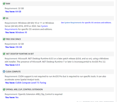

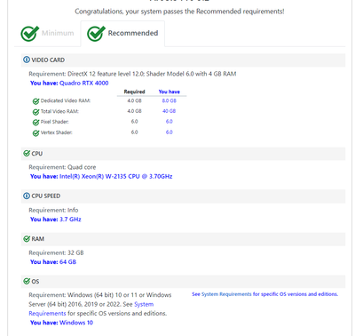

MK13
@RonaldHaug I have a pretty good system as you can see from the specs above.

Looks like you have enough under the hood.

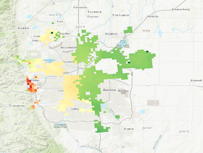

This is my initial result for a sample service area but I am far from done. I still have to read about the rescale functions and make them work for my data.
