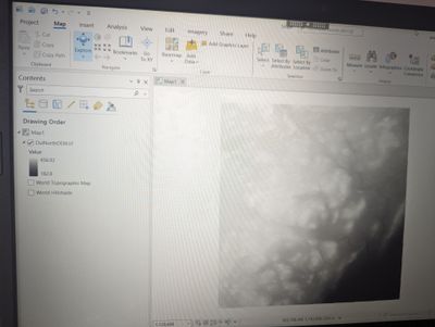

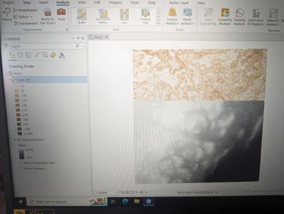

I am struggling. Trying to apply a raster slope to a DEM . Final slope is only partly appearing on my map. Pictures provided, one is what's it's  I'm completely lost as to what is wrong

For starters refresh your map screen (bottom right corner).

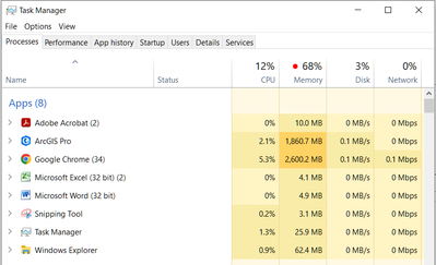

Next open your task manager and see how much memory you're using.
Check to see if your computer meets system requirements.
https://pro.arcgis.com/en/pro-app/latest/get-started/arcgis-pro-system-requirements.htm
Sometimes all you have to do is refresh. If your memory is maxed out, turn off or remove the DEM from your map. Then save project.  Close down unnecessary programs or browser tabs to free up memory.
Raster processing and display uses more memory than vector processing.
