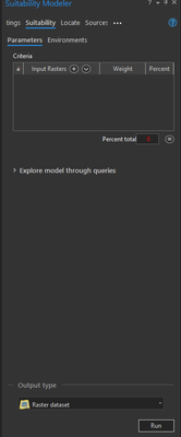

When I re-open an existing suitability model from the content pane, the parameters no longer appear under the suitability pane and I am unable to make an further changes to transformations and weights. I still see all the transformed rasters under sources but they are not in the suitability pane or the group layer. Any recommendations on how to resolve this issue would be greatly appreciated.

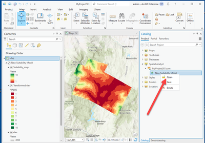

...and, if you've not opened the Suitability model after opening the ArcGIS Pro project, see the image below on how to open it.

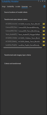

PaulBooks_CoA
Hi Steve,
Thanks for your reply. That is the same process I used to re-open the model. Below is a screenshot showing the source rasters and the suitability pane having no visible parameters.

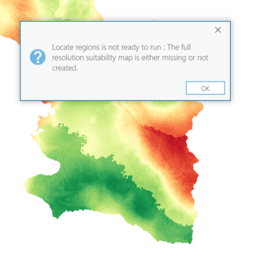

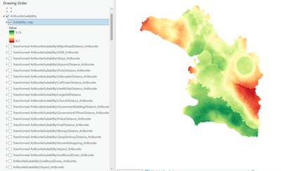

I am having this exact issue and have no clue whether I should just stop using the suitability modeler and use a classic method to weigh these layers. All of the transformations are removed from the parameters and I cannot locate regions unless I do the transformations all over again. The suitability map is still in the project but somehow no longer linked...
Error message
SteveLynch
I'm sorry to hear that you are having problems.
What version of ArcGIS Pro are you using?
Once you've done the transformations you need to create a full resolution Suitability map before doing Locate Regions. If you look at the properties of the suitability raster you'll notice that it is an .afr (a function raster) and it needs to be persisted to a full resolution resolution raster. This is all done within Suitability Modeler.
