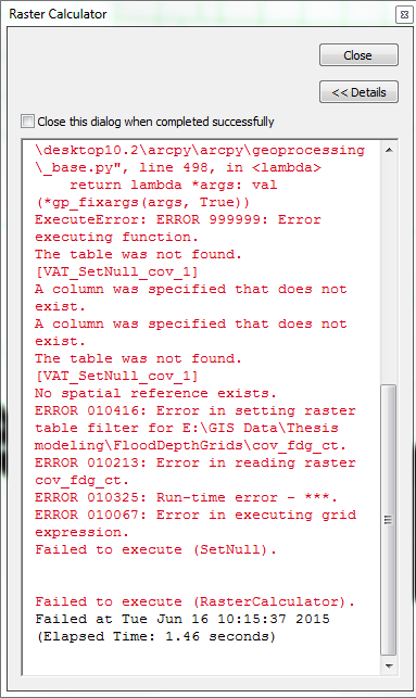

Hi Everyone,
I'm using the expression below to try convert all the values that are negative or equal to zero to NoData
SetNull("cov_fdg_ct" <= 0,"cov_fdg_ct")
But it failed to execute with the error message below:
Executing: RasterCalculator SetNull("cov_fdg_ct" <= 0,"cov_fdg_ct") "E:\GIS Data\Thesis modeling\FloodDepthGrids\cov_fdg_c"
Start Time: Fri Jun 12 17:49:33 2015
ERROR 000539: Error running expression: rcexec()
  File "<expression>", line 1, in <module>
  File "<string>", line 5, in rcexec
  File "c:\program files (x86)\arcgis\desktop10.2\arcpy\arcpy\sa\Functions.py", line 320, in SetNull
    where_clause)
  File "c:\program files (x86)\arcgis\desktop10.2\arcpy\arcpy\sa\Utils.py", line 47, in swapper
    result = wrapper(*args, **kwargs)
  File "c:\program files (x86)\arcgis\desktop10.2\arcpy\arcpy\sa\Functions.py", line 309, in Wrapper
    ["SetNull", in_conditional_raster, in_false_raster_or_constant])
RuntimeError: ERROR 000732: Input Raster: Dataset cov_fdg_ct does not exist or is not supported
Failed to execute (RasterCalculator).
Failed at Fri Jun 12 17:49:34 2015 (Elapsed Time: 0.16 seconds)
I've been reading many posts from those who also got the ERROR 000539 and most of them seem to be due to a syntax error. However, I can't seem to figure out what syntax error is in my simple expression. It would be much appreciated if you can provide some advice!
Thank you!

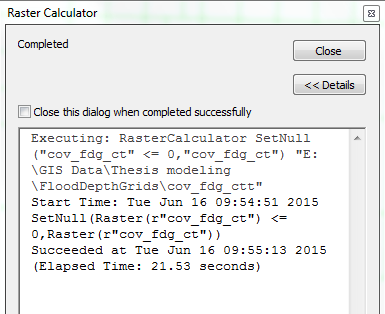

Zheng_KiYip
Thank you so much for all your advice and responses! Sorry for the delayed reply - I haven't had access to this GIS machine again until today.
To my surprise, I used the same syntax as I did last week and it got executed successfully as below. Any suggestions to what may have changed?

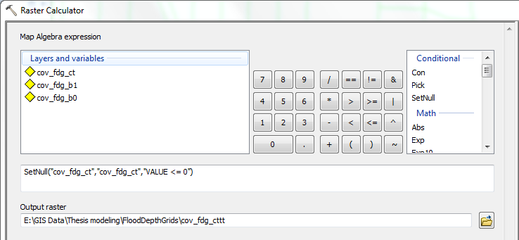

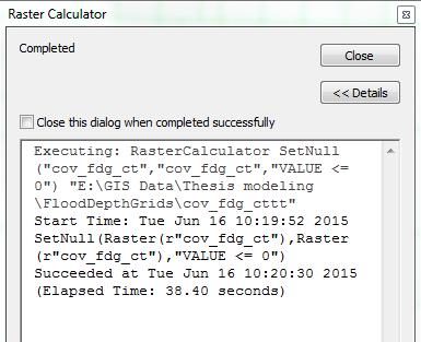

Darren and Dan - Last week before I posted this message, I have also tried the syntax you have suggested (i.e. including the where clause) but I got the same error. However, when I tried again today, it worked also as shown below.
What I have found interesting was that when I took out the space between the = and 0, it no longer works
