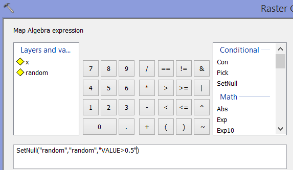

The Results of a test....  Raster in ArcMap 10.3.1 TOC,
Select ... ArcToolbox, Spatial Analyst Tools, Map Algebra...Raster Calculator
random raster appears as a selectable raster.
Enter the expression shown in the image below WITH a where clause, doesn't give an option for where, but what the hey...I put one in.  The results from the Results window
Messages
Executing: RasterCalculator SetNull("random","random","VALUE>0.5") F:\Test\x2
Start Time: Fri Jun 12 23:07:49 2015
SetNull(Raster(r"random"),Raster(r"random"),"VALUE>0.5")
Succeeded at Fri Jun 12 23:07:52 2015 (Elapsed Time: 3.25 seconds)
Conclusion....surmization...
The raster calculator whips in the Raster around the inputs ( I should have been more inventive) but uses the where clause
Guess they should separate out raster calculator help or show some examples
