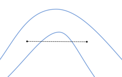

The other thing to keep in mind is the shape of the river. A TIN probably won't generate correctly around a bend if the river is quite sinuous, unless you've got points at fairly frequent intervals in those spots.

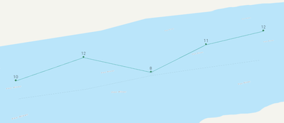

Yeah, it would be overkill. Here's a fairly simple idea, which does not require much beyond basic tools and editing:
  1. Add your depth points as a z-enabled dataset, and have it read the depth as the z-value. (May help to work in a Scene. In my example, I've labelled the points with their z value)
    1. If you're importing a spreadsheet, XY to table lets you specify an optional Z
  2. Digitize a line between these points, using a z-enabled polyline layer. I've applied a large Z exaggeration to show the z value more clearly.

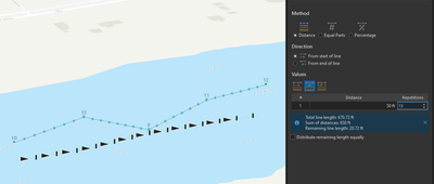

  3. Select your new line and use the Divide tool in the Modify pane. Choose whatever method suits you, but make sure you end up with nice, short segments.

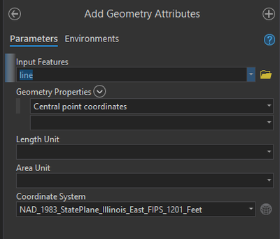

  4. Use the GP tool Add Geometry Attributes to add the central point coordinates of each line to the attribute table.

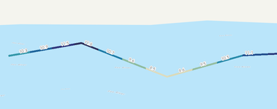

  5. You now have a numeric field representing the rough height of each segment! Visualize your line layer on that field, or even apply a definition query to isolate those segments which are above a certain value.jcarlson_5-1615392170751.png

Thanks for all the help. I still have a few questions though (I'm very much at the beginner level here). So I converted my points to a polyline z and divided it into segments. But after that, would Add Geometry attributes automatically calculate the value for each segment our would I have to Split them first? In the attribute table the line would still just show as one object.
Cheers,
