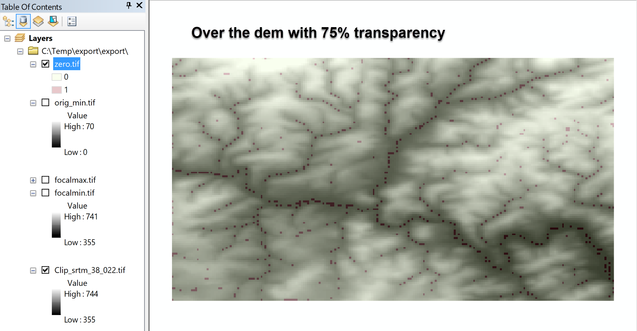

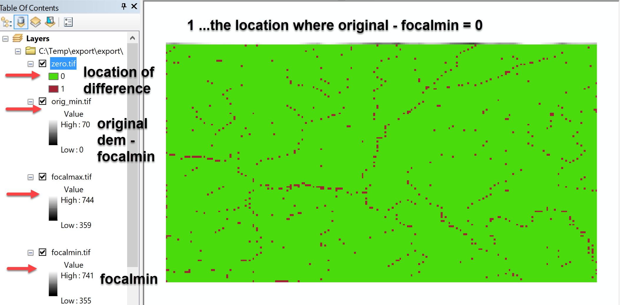

Is this what you are looking for?
Over the DEM with transparency
FidelTedla
This is not what I am looking for. This is the original raster minus the Focal Min raster. As explained in one of my posts above this is not giving me what I am looking for. I am looking for the location of the min or max for each central cell. That means the number of min or max locations to be identified must be equal to the number of cells in the original raster.
