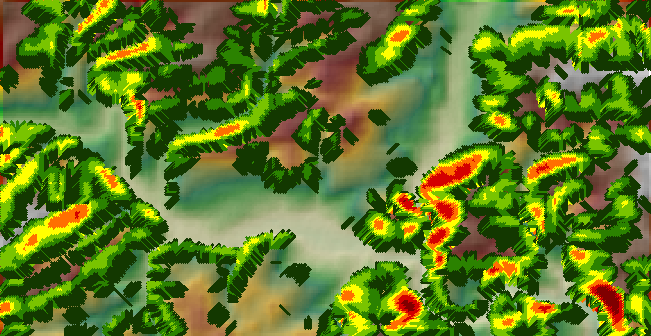

If I color the lines by drop value and apply a minimum drop for the polyline to be generated (25m) this is the result:
I you look at a part of the area closer (showing only the largest drop values) you can see the effect:

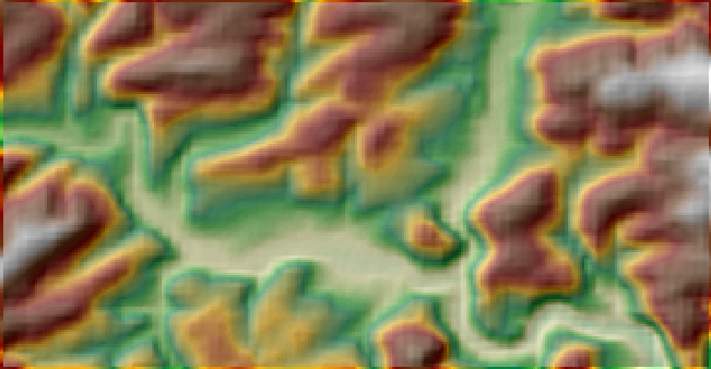

Comparing it to a simple slope map:

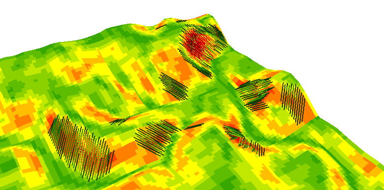

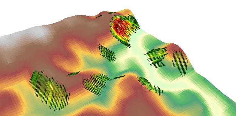

and the lines on top of the slope raster
