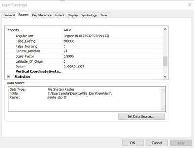

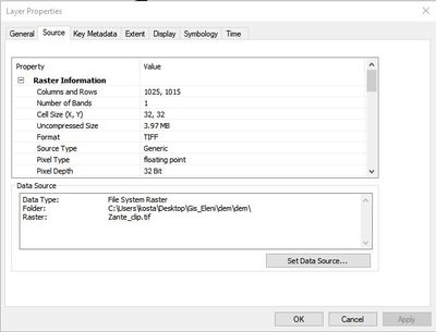

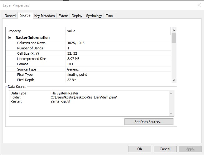

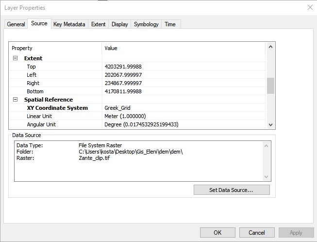

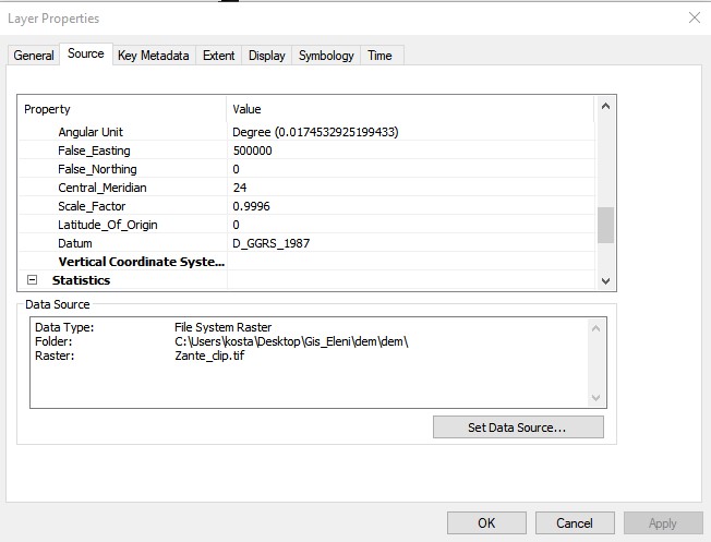

I am having a problem with a dem of a greek island. I want to use the Euclidean distance tool but I get back the same dem without the distance raster. I draw a random line trying to test it, but it keeps failing. Why ?
The only thing I can provide is some details of the raster
