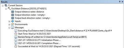

Hello,
I am having a problem with a dem of a greek island. I want to use the Euclidean distance tool but I get back the same dem without the distance raster. I draw a random line trying to test it, but it keeps failing. Why ?
The only thing I can provide is some details of the raster

You say you are getting back the same DEM. But, I think the result you are getting back is all NoData. And I think the reason for this is because you are specifying a barrier over your whole study area. The Distance calculation will not process areas that are a barriers.  Barriers should be nodata in the result.
If you want your calculation to process from the line to the coast then the line is your source and the coast is the barrier (not the whole study area).
Instead of using the DEM as a barrier please try using the dem as a mask, in the environment settings. But in order for this to work the pixel values in the DEM surrounding the island need to be nodata not zero.
Liz

I think that helped a bit. I forwarded some screenshots of my results, which are limited only along the line and not the entire island. What am I missing?
Thank you very much for your help.
