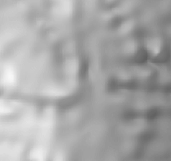

I have a collection of data points from which I am trying to generate a DEM and, ultimately, a hillshade for use as a backdrop in a map. Whichever way I try to process it (using Topo to Raster) I get artefacts where the points are located. See the attached example:Capture2.JPG
Any ideas what might be causing this?

You may want to use a different surface creation method than "Topo to Raster".
Off the top of my head, Inverse Distance-Weighted (IDW) may work out better as a surface creation for then creating a hillshade.
Also, if I remember correctly, Natural Neighbors is the one that makes high points more extreme than in real life (much like the result you posted), so avoid that one.
Additionally, note that the number and distribution of your input points can factor into your results too, so you may have to experiment with several methods to see which works best considering your available data.

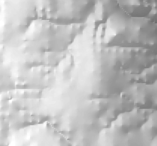

Well, I tried your suggestion and the result is worse than the Topo to Raster result. See below.
I'll be trying some of the other interpolation methods and getting back to you on my success (or lack thereof).

Kriging (top), Natural Neighbour (middle) and Spline (bottom) are not much better.

Oskar - I have tried creating a TIN. The TIN looks fine but converting that to a DEM results in an entirely different set of artefacts, one that appears to have many of the single cells outlined.
Most of the elevation points are about 195 m apart with other points added in along streamlines. I am contacting the original creator of the data to find out what process they use and what issues they've come across.
