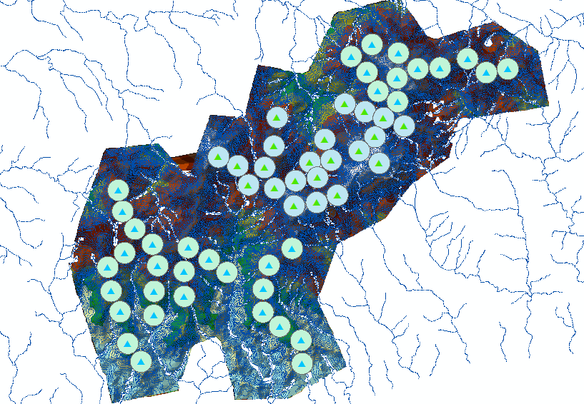

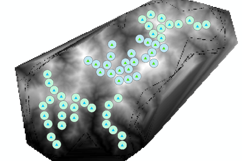

I would like to be able to calculate a "Terrain Ruggedness" index for each one of my sites in my study area and found a couple different suggestions, but I think calculating the standard deviation of elevation would give me useful values.  The problem is I can't find how to calculate this within specific buffers.  For example, I have made a TIN from a contour shapefile around my sites (Figure 1; edited with river shapefile) and then converted that to a Raster shapefile (Figure 2).  I've made 500m buffers around each site and would like to calculate the standard deviation of elevation within those buffers for each site.  OR really any kind of value that could measure "terrain ruggedness" within each buffer.

Figure 1. TIN
Figure 2. Raster

Have you looked at the Zonal Statistics Tool?  It should be able to calculate the standard deviation for each different buffer area, if you select STD for the statistics type.

I used Zonal Statistics and got this, which I think is definitely a step in the right direction, but I'm still confused on how to calculate the mean elevation of each buffer if this is all one shapefile and I can't seem to find an attribute table associated with it?  Any advice?

What did you use for your zone field?
Are all your buffers a single entry in the attribute table, or does each have its own record in the attribute table?  If they each have unique ID's then the ID field could be used as the zone field, so it calculates only the std for that particular ID area.
Also perhaps I should have pointed you towards Zonal Statistics as Table Tool, it seem more like what you are looking for.
