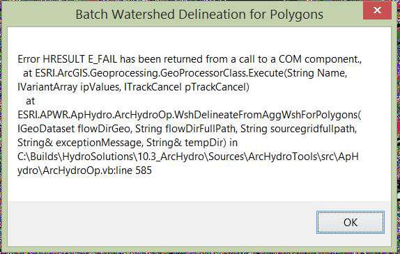

I would like to delineate watershed for polygons which represent lakes. However, I received an error which is attached below. From the information which I found in the forum I should change in my attribute table values -1 to 0. I did this; however, it did not change anything, I am still occurring the same error. Is there some way to solve this error? Or maybe another approach which can be used to delineate watershed for polygons? Thank you in advance for help.

I did the pre-processing of my data twice: once using Spatial Analyst Tools > hydrology, and second time by using tools available in ArcHydro. I still have the same error.

That error message, and variants, come up a lot with ArcHydro... see this thread Error in DEM Reconditioning in Arc hydro 10
a recommendation there is to look for an 'archydro problem solver' thread and to move any files off of servers to local machines.
I will flag  Arc Hydro​ to see if anyone there can provide some guidance
