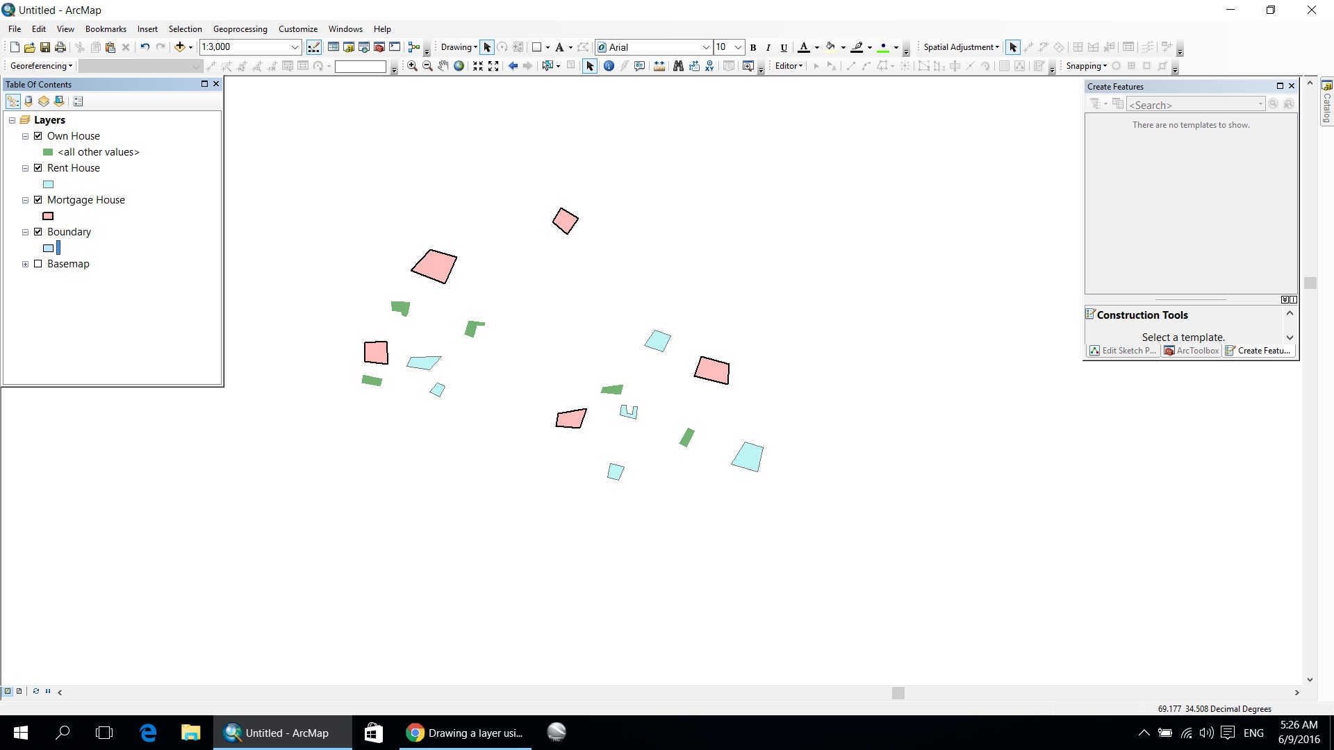

I have prepare a concept plan as your instruction. In first screen shot as you will see I draw polygons to houses which has ownership, rent and mortgage.
In second screenshot I want to analysis like that to show boundary of predicted or area neighborhood that in which area number of old houses has more ownership, rent and mortgage as my result.

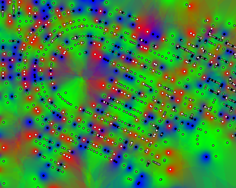

Here's my immediate idea (whether or not it is technically appropriate, I'm not sure):
1.) Add three new fields (own, rent, mortgage)
2.) If ownership = Own, make the own field = 1, else 0. Same for the other two fields.
3.) Run your interpolation (IDW or other) separately for each situation
4.) Your interpolated rasters should be between 0 and 1 (those are the estimated percentage of each situation at each pixel)
5.) For display, multiply each of your rasters by 255. Then, run Composite bands using those rasters to make a new raster with red = own, green = rent, blue = mortgage. You should end up with something like this:
SteveLynch
Problem with interpolation of a non-continuous variable can be thought of as follows. 1000 people live here and 2000 people live there, how many live in between? 1500 ?. No, these could be two small towns on either side of a large city or there could be a lake in-between. Population, lightning strikes, tree diameter are all examples of non-continuous data that should not be interpolated.
-Steve
