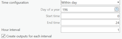

Thank you for the quick reply! I guess this refers to the settings when I ran the tool? I'm attaching a screenshot of the time configuration.

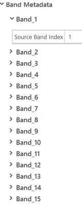

the result I got has 15 bands and they are named Band_1, Band_2,....Band_15 but I don't know what hour of the day these bands represent. I ran the same tool for December 15, and the result has only 9 bands. So I guess it only includes hours/bands with solar radiation but how can I know what the hours are?

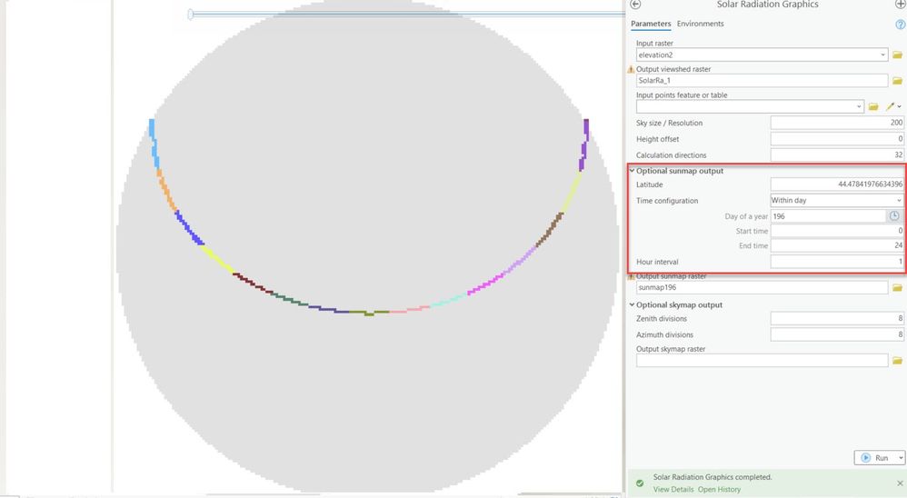

Hi @ShirleyYueLi  (coming in late.. better late than never?)  Just wanted to add for future reference.
You are correct in your interpretation of the number of bands and the hours of sunlight.
This can be represented by the Sun Map Calculation .  You can run this using the Solar Radiation Graphics tool.
In terms of the specific hours... this is dependent on your location (latitude) and day.  The sunmap sectors are calculated based on the time configuration, in your case one full day from sunrise to sunset (available light), where each sector is based on the interval specified for your time period.  Unfortunately, the specific hour of each sector is not specified as an attribute in the result.
Good luck!
example sunmapexample sunmap
