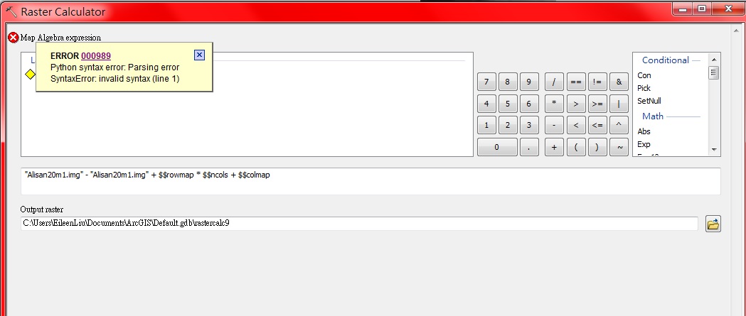

Professor give us formula :  [your dem] - [your dem] + $$rowmap * $$ncols + $$colmap

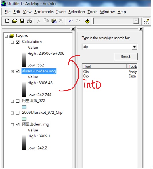

ps. My original dem is alisan20mdem
(my prsfessor 's version is 9.3 and I was 10.2.2 )

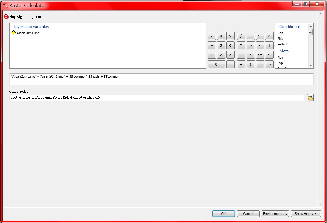

so..i type formula on and got error message
At first i thought that problem is about Alisan20m1.img , so i delete it

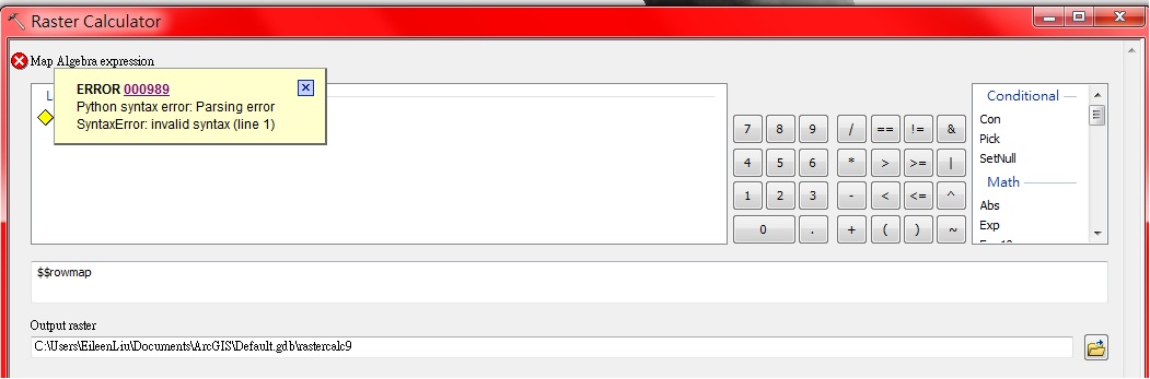

but i found the main problem is $$rowmap !!!  if i type it on  , it would show error message .
but i leave the formula that[ Alisan20m1.img - Alisan20m1.img ] and the message disappeared .
what can i do ?? please teasch me....thank you very much
curtvprice
MVP Alum
$$ROWMAP and $$COLMAP are not supported in the 10.x Raster Calculator. Sorry about that. There are some workarounds but they aren't pretty and involve using Python scripting - not the Raster Calculator.
