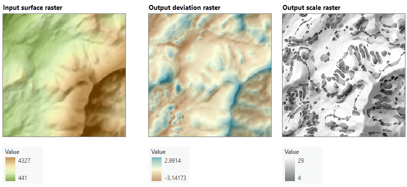

A new tool is available for the collection of tools that identify specific landscape characteristics of a surface raster at multiple scales. The Multiscale Surface Deviation tool calculates for each input cell the maximum surface deviation from the mean value across a range of spatial scales. The outputs from the tool record what this value is, and the other the scale at which it occurs. This new tool can also take advantage of GPU hardware, and could produce an output up to twice as fast compared to only using the CPU for calculations.
The following graphic illustrates the results from this new tool. The panel on the left is the input elevation surface raster. The middle panel is the output deviation raster. The ridges (darker blue shades) show larger positive deviations from the mean, while the valleys (darker brown shades) show larger negative deviation values. The panel on the right is the scale output. The white areas show locations of larger deviation values found at the larger scales. The darker areas show where larger deviation values are found at smaller scales.
You can use these deviations and scale raster to validate hydrologic features from your surface data.
