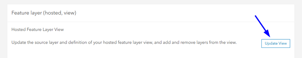

@AlisonAbercrombie  Alison, to update the view layers you'll need to go the each view layer's item page, go to settings, then down the page you'll see 'Update View' for the layer. Go through that walkthrough and you can then pick the newly added fields you created in the source layer, and make them visible for the view layers.
I haven't used the tree solution but a different solution with view layers. I did the same thing with adding custom fields and needed to do the above workflow.

This would be a much easier solution but I cannot find Update View as an option in settings for the layers?
JonM32
@AlisonAbercrombie There should be a source feature layer where all the views were made from. In the screenshot, the source would be the Feature layer (hosted) and then below are 2 view layers created from it. I'm assuming the tree layer is the same and if you searched for it in the Contents of AGOL, it'll likely have a Feature layer (hosted) version which is the layer you can go to settings for and find that update view button.

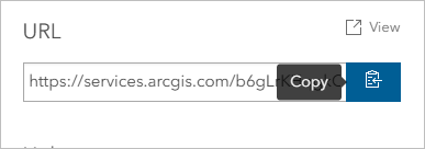

  1. From the item details page of the Trees_currentinspection view, copy the service URL into a text editor. This will ensure you have the unique name of the view. It may simply be Trees_currentinspection, but if the Solution has been deployed multiple times in the same organization, it may have a guide suffix like: Trees_currentinspection_ae0f74dea4a44bf992bf0b00b97887ef. Repeat for Trees_inspections.MikeDagle_0-1749582281696.pngMikeDagle_0-1749582281696.png
