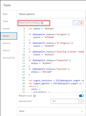

Surprise! I actually managed to solve by modifying the Arcade script in the Dashboard Configuration -> Table -> Values.
There are two lines (19 and 20 at the time of writing this post) that contain variables:
var urgent_textcolor = IIf($datapoint.urgent == "Yes", '#ffffff', '')
var urgent_bgcolor = IIf($datapoint.urgent == "Yes", '#a11506', '')
Just below them on line 21 through 25 I added another variable:
var name_assigned = IIf($datapoint.assignedto == "[email protected]", 'Jane Doe',
IIf($datapoint.assignedto == "[email protected]", 'John Doe', ''))
Then I replaced the "displayText" for a column return like so:
assignedto: {
displayText : name_assigned,
textColor: '',
backgroundColor: '',
textAlign: 'left',
iconName: '',
iconAlign: '',
iconColor: '',
iconOutlineColor: ''
Success!

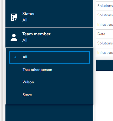

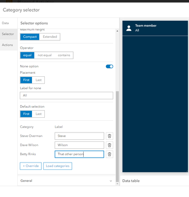

Hi @Cierra_Scriven ,
For the filters in a dashboard, go to that filter and under "selector" scroll down and click "Load categories".  You will see their email in the "category" listing and you can change the "Label"
BrandiRank22_0-1723574905565.pngBrandiRank22_0-1723574905565.pngBrandiRank22_1-1723574937165.pngBrandiRank22_1-1723574937165.png

Hi @CierraScriven , can you elaborate on where you can find "Dashboard Configuration -> Table -> Values."  Is this an enterprise direction or an AGOL one?  Is this on a specific dashboard?
DanielWickens
@Kara_Shindle - Cierra is referring to the Values -> Advanced formatting section of the Table element configuration options. This is the case in both ArcGIS Online and ArcGIS Enterprise.

In the Value options - Advanced formatting
var email = $datapoint.assignedto;
var username = split(email,"@")[0];
then
assignedto: {
      displayText : username,
      textColor: '',
      textAlign: 'left',
      iconName: '',
      iconAlign: '',
      iconColor: '',
Happy days 😊
