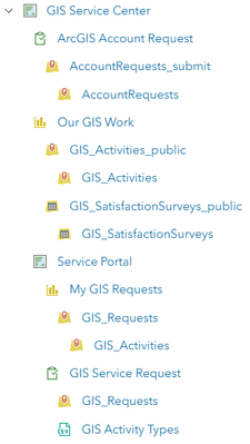

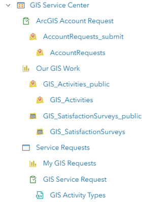

Is there any way to redeploy a solution to bring back features or layers that were either accidently deleted or disconnected from their original service layers?
We deployed the GIS Management Solution back in June and Sometime between then and now the Service Request Feature Layer disconnected from the GIS Activities Layer. I assume it may have been when I converted the survey123 from online to connect and re-published it with schema changes.
Current Solution.
What its suppose to look like.
Thank you very much!

I had discovered when I converted the survey form into a survey123 Connect form, I changed the Geopoint to a Geoshape with repeats which I assumed caused a conflict with the GIS Activities layer which still used points and thus it disconnected it entirely and made a whole new feature layer. I re-created the Request layer as a view from GIS Activities and tried using Geopoint instead without a repeat in the survey, but when ever I add a record, it is not synced over to the GIS Activities main feature layer. When I first tried publishing it, I kept getting an error about submission URL is not compatible with this survey.
I have already put in a ton of hours into the hub sites and design so I was hoping there was some way to redeploy the solution by having the missing layers re-added to the solutions main list of items just incase I am missing a component or setting somewhere.

Have no fear!  The GIS_Request was a view of the GIS_Activites.  No need to re-deploy.  You will need to recreate that view (could also be in your "recycle bin" if that was in AGOL when this happened) and then reference it in GIS Request Survey, etc.
Re-deploying wont' save you time and will create a lot more items than you need.  🙂
See a post I added to this ArcGIS Solutions Community which has the solution diagram which may help with seeing how all the components line up!
