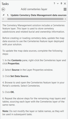

I have just recently deployed the Cemetery Mapping Solution and I am following the Use Cemetery Management on the solutions help page. When I download the Cemetery Data Management ArcGIS Pro project, unzip and open it, the features are all unlinked (red exclamation marks). Furthermore, the gbd in the file is empty. Did I miss something or is this broken?
DanielWickens
@AlexanderJohnston - This is expected, we ship the Pro Project with broken data sources. The Cemetery Data Management ArcGIS Pro project includes a task in the Getting Started task group for updating the map data sources to use the Cemeteries feature layer deployed with the solution.
AlexanderJohnston
I am not sure how I missed that. I appreciate the help Daniel!

Is the Pro Project download still available? All I see is a Deploy wizard for an ArcGIS Online Solution. If I use the Deploy wizard it creates the objects in my Online content but I'm not finding anything like the Tasks shown above in the Pro Project that takes me through the steps to get everything configured.
WeldonHoppe
I see you have to download the project using the Computer Data Management template from the Online deployment objects.
