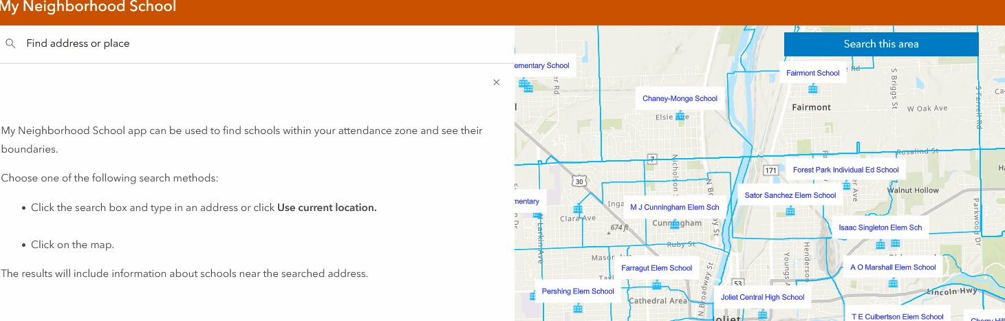

4. I added labels to schools in the webmap. They do not appear after a search. They only appear without a search.

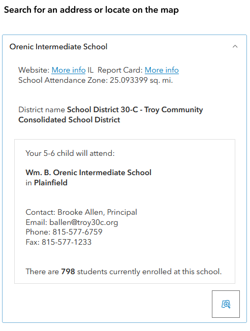

5. Any way to move the related record above district info?

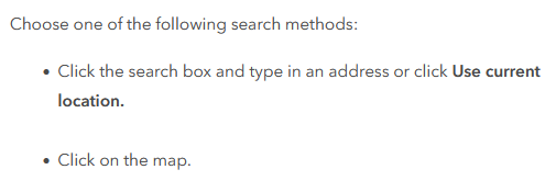

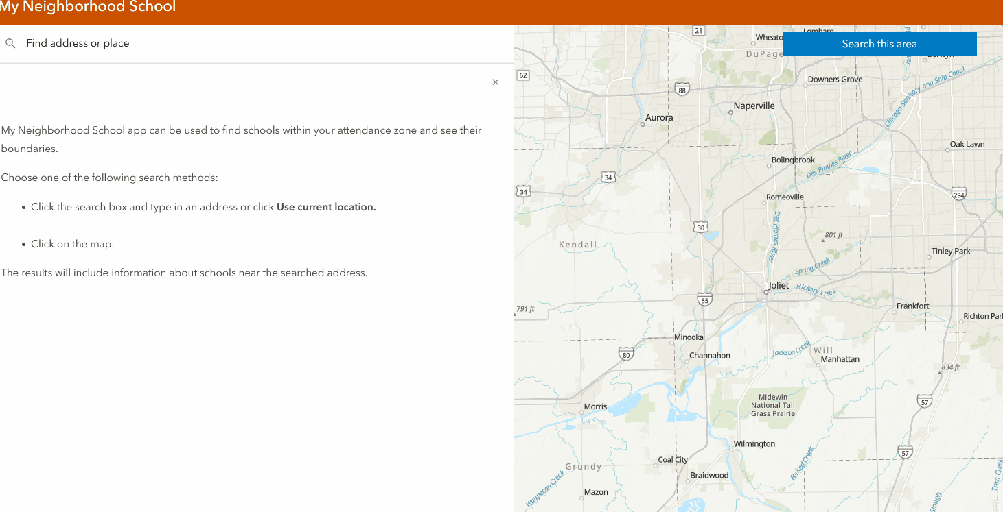

@JaredPilbeam2 There are a couple of things are going on that I think can help you fix your app. I'll go through your questions below:
1. Your app has a search method of "Map extent" set. The solution uses "search radius". Search radius method allows for a map click, and then the clear search button appears. Map extent search method has a button to "search this area" since it's a map extent based search. This update can be made in the Nearby section > search method.

4. Labels - I'm still investigating this one. I see labels showing in my examples but will keep looking into this.
5. At this time, the expanded related result is below the pop-up.
