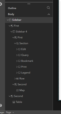

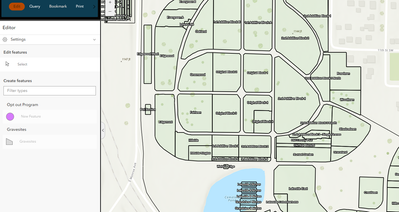

I had issues and it seemed outdated to me so I recreated the apps in EXB for more flexibility. Crowdsource is just not a good application.

This is the public viewer: https://experience.arcgis.com/experience/a89b4862cc9b4149b8bc791709f24c13
My editor for internal employees is very similar:
Normally to update a view layer you can go into your settings for that view layer and their should be an update view tab. It isn't coming up for me on that specific layer though. You could go through the layers in the solution and update the views that it allows you to.
