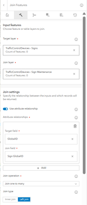

@AdamCottrell - We don't explicitly document how the join views are created.
The Sign_mainthistory and Pole_mainthistory views are both 1:M join views based on the globalid – assetglobalid relationship between the asset layer and the maintenance table, showing the entire maintenance history of the assets.
Here’s a snapshot of the settings for the Join Features tool in Map Viewer. Creating the Pole_mainthistory join view works the same as creating the Sign_mainthistory join view, just with the Poles layer and Pole maintenance table. Same applies to the join views in the Signal and Streetlight solutions.

Thank you Sir!  I believe this is what I needed.  I now need to test by removing the existing joins and add my needed attributes fields and then add the joins back.  Again, thank you!  I greatly appreciate it!
