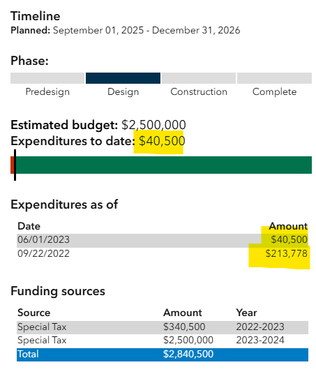

I was wondering if something was broken in our solution setup or if we are using the "Spending" related table in the way the application is configured.
The arcade expression built does not total the expenditures in the pop-up, from what I can tell... The bar representing "Expenditures to date:" does not represent the total of all expenditures (Spending related table). I've copied the arcade expression I believe needs to be adjusted, but I'm not confident enough in my Arcade to edit and risk reconfiguring the solution.
If this ISN'T intended to be used with multiple entries for expenditure, are there ways to configure to support? We would like to use this related table to note contract pay outs categorized by design phase (category field) / vendor (description).
Thanks in advance!

It looks like you'd just need to get the sum of the costamounts field in expendituresFS instead of using the most recent expenditure record.
//budget values
var expendituresFS = FeatureSetByRelationshipName($feature, "Spending");
var actcost = Sum(expendituresFS , 'costamount')
var estCost = $feature.estcost;
var totalSpending = 0+ actcost //not sure why you need "0+" in this line
var budgetRemaining = estcost-actcost

We are working through implementing this solution as well, and we also found that the way the solution is designed to work is you enter the running total in the spending table each time you have a payout. We did not want it to work that way either and you have to change the actcost to use the Sum function in each of the different maps that has the Spending/Expenditures information.
You can also update the embedded HTML in Arcade to update the table element to show the category field. Here is one example from the Capital Project Tracker web map.

Hi Josh,
I'm running into some limitations on my actcost field calculations CPC (Capital Project Coordination) Solution Related Table(s) Limitations?. Do you mind sharing if you're also running into this issue? Attempting to troubleshoot at the moment if it's a function or table limitation. Thanks!
MikeDagle
Hi @LeahBowyer,
As designed, the Cap Project Coordination Solution is configured to store and return the total expenditures to date, rather than individual pay requests. We configured it in this way for simplicity, but the Solution can certainly be extended to track individual expenditures/pay requests. Based on the comments, you're on your way to doing just that.
