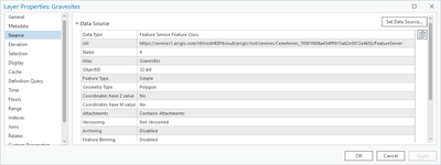

Can you check to see if the source of the Gravesites feature class in ArcGIS Pro is the same in ArcGIS Online? They should both be using a hosted feature service as the source. Can you also confirm that the settings for Z values is No? Screenshot example attached.
BrianShepard
@DanielWickens Yes. That's the first thing I checked. The edits do show up in both places - if I make an edit in Pro, the AGO webmap shows the same edit; if I move a feature in AGO, it shows up in Pro, but only at some scales.
I checked the Z value setting even though I didn't see how it was possible to copy a feature from the dataset and have it's Z value differ from the feature I was copying. It only made sense to me that this could occur when copying features between datasets with different settings.

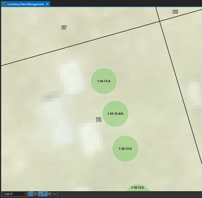

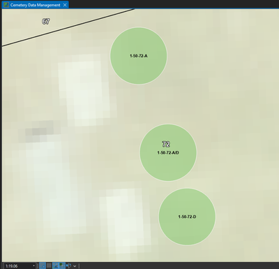

It may not be super easy to tell, but at 1:19.06 1-50-72-A shows in it's original location.
At 1:29.77 it is in the location where I moved it in AGO. I don't believe this behavior is consistent (different scales, changes when panned). Seems like it may be cached somewhere.
That issue isn't as much of a priority as being able to edit features in Pro, however.
