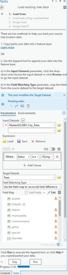

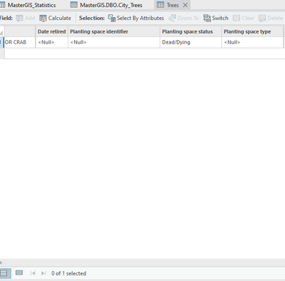

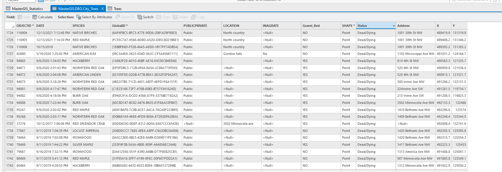

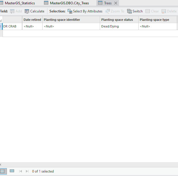

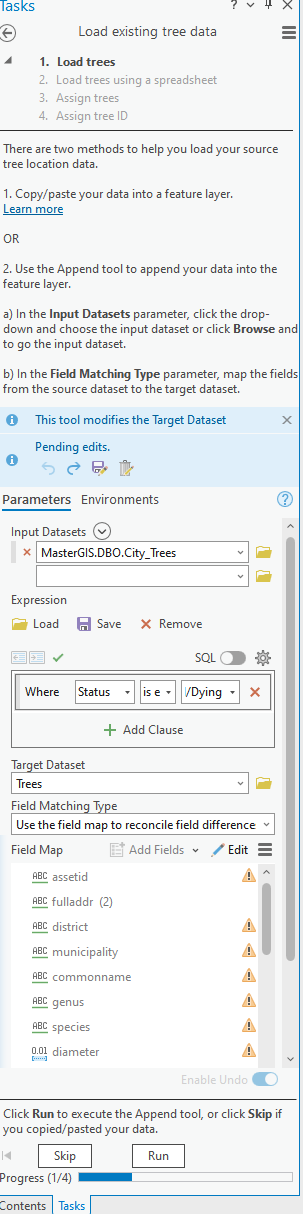

I thought things were loading but now I realize not all my data is loading when trying to import trees into the Tree Management system.  In my sample I'm just trying a subset because it runs quicker.  When I try to load all the data, I have the same issue.
As this pic shows, I have many Dead/Dying trees
I run the load tool
Only one row loads, there should be 38 rows.
When I try to run the whole dataset only 772 out of 2800 rows load.  I don't see any consistency in what loads or does not load.  Please help.

Update: Daniel helped me find an error loading a Text Field into a strict domain controlled field.  By looking at Analysis > History we saw the Append tool failed and identified the error.  Once we remapped the problem field the data loaded.  Thanks.
