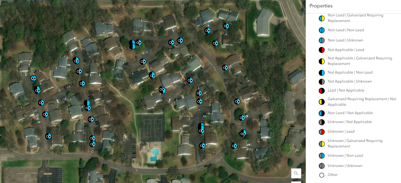

I am attempting to implement the Lead Service Line Inventory Solution. We have some scenarios where the utility or customer side is "not applicable." Therefore, we would need to add a new domain and symbol.
Has anyone successfully added new domains and symbols to this solution? I attempted but everything is broken now.
The Lead Service Line Viewer map looks great! (image below, with added "not applicable" symbols)

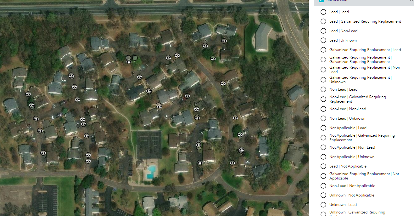

But if you look at the Lead Service Line Viewer web app, the symbols are not being honored.
I'm not shocked since the solution relies heavily on these domains. However, I'm wondering if anyone has figured this out! Thanks in advance.

AlexKabak
Hi, please see the attached video walking through the steps to update the symbols. Those white symbols are the result of an edit template issue when updating the symbols. Hope these steps apply and let me know if you are still having issues. You can also repeat these steps for other maps in the solution as well.
