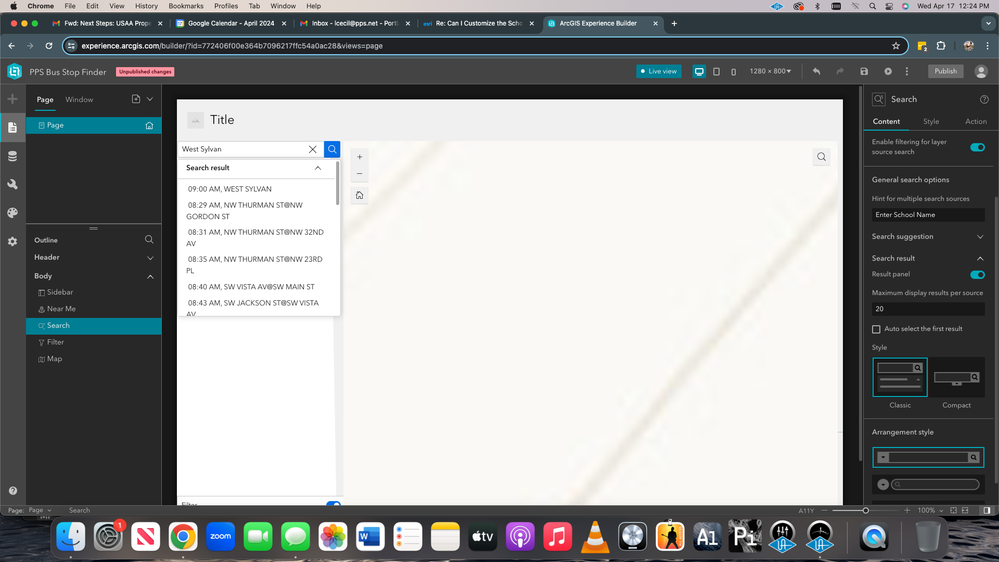

Hey Chris, I finally started working on this. I got it working, showing me only bus stops associated with the school I enter into the search bar. The problem I'm seeing now is that I can only have a maximum search result of 20 in the Near Me tool. Some of our schools have dozens of stops and we need to display them all. Also, are the search results based on proximity, or just the order of points in the attribute table? It would be nice if we could filter by school and display closest points at the top of the list.

I followed the steps in this blog post to search by school to see only the bus stops associated with that school. I'm kind of lost on how to make this happen. Again I don't care about proximity or distance, I just want to type in Lincoln and see all of the Lincoln bus stops in a list, and be able to click and zoom to bus stops. Is this possible with Near Me? In the example below I searched for West Sylvan middle school and I see 20 stops. There are many more stops than that, but that's the maximum allowed
