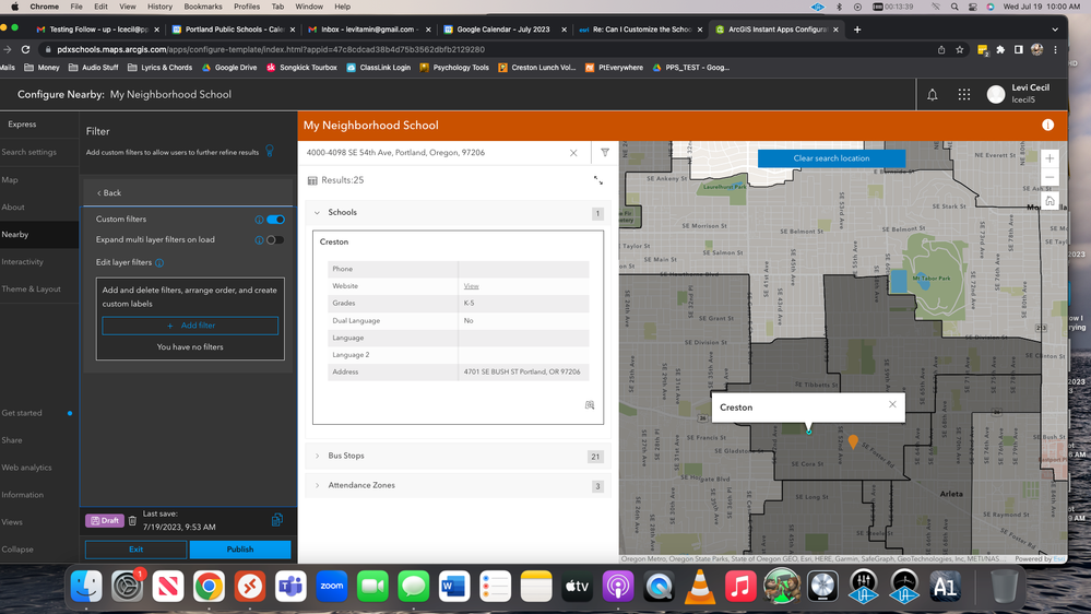

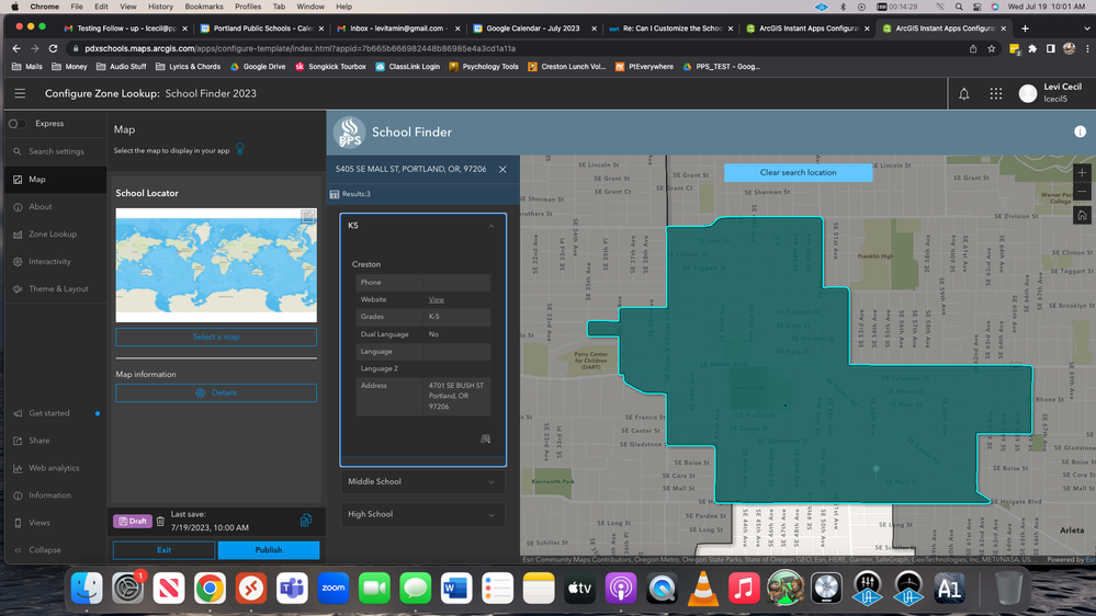

LeviCecil
OK, thank you. I'm confused on how to set the filters. What I want to see is in the first screenshot. I used to Zone Lookup to show the three schools (K5,Middle, High) for an entered address. I'd like to also see only the 5 bus stops associated with the K5, and the bus stops associated with the other schools as well, based on their site IDs. My Neighborhood School is showing me every bus stop within a radius, some of which aren't associated with any of the 3 schools in tied to that address. Would this be possible?
Zone Lookup:
My Neighborhood School:

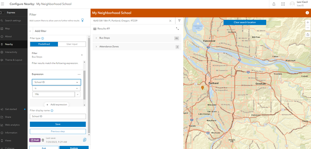

LeviCecil
It doesn't look like I can accomplish what I need to do with the Nearby tool. I need an Arcade expression that matches the Bus Stop to the school IDs for the attendance zones returned in the search. This only allows me to set a specific school ID in from the Bus stops layer. There shouldn't be 46 bus stops returned in this search.  busstops.PNG
ChrisFox
@LeviCecil, I am seeing similar limitations in both Zone Lookup and Nearby. When I tried creating another relationship between the attendance zones and bus stops they were still not being filtered when I returned the zone. We will need to look at this for a future update of the solution to allow you to filter the related bus stops.
