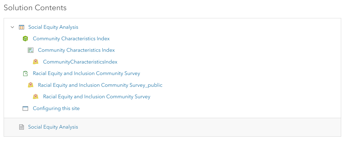

I've deployed the ArcGIS Solution - Social Equity Analysis.  According to the documentation, there is supposed to be an ArcGIS Pro project that is part of this solution.  But I don't see a download option for this project on the item details page nor do I see the Pro project listed in the contents.  Why doesn't my deployment work?

The link you sent doesn't provide information on how to download the Social Equity Analysis Desktop application template.  I only see instructions to click a download button on the Social Equity Analysis item details page.  I don't have a download option after I deploy the solution on ArcGIS Online as directed.
MaryU
Okay it looks like the project is in the solution:

@HeatherEisan I am having the same issue. After I click deploy and then open once the I download the social equity analysis tool, I am unsure as to how to access the interphase to begin doing the work. These are the options I have under solution contents:
MichaelBrown12
@CodaRayo-Garza In the screenshot provided, the Social Equity Analysis ArcGIS Pro package is the Desktop Application Template item. You'll need to open the item details page, download and unzip the file to be able to access and open the Social Equity Analysis tasks in ArcGIS Pro. There are instructions to help in the Analyze Social Equity section on the documentation site.
