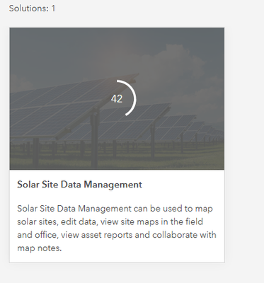

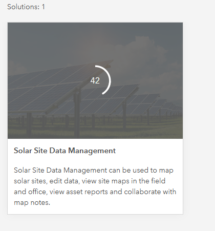

But when I first try to deploy one, I enter the WKID (in this case 6578 but I've also tried with 3857) and after a couple minutes the percentage gauge hits 42
hangs for a bit, then I get a generic error saying it failed to deploy.
Is there anything I'm missing here?

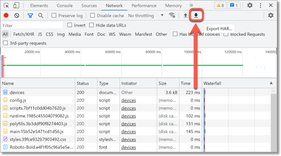

Could you please:
  1. Open the browser debugger (Ctrl + Shift + I)
  2. Attempt to deploy the solar site solution again until the failure occurs
  3. Go to the Network tab, then Export HAR (see screenshot below), and send us the HAR file
This will help us narrow down where the failure is happening.
