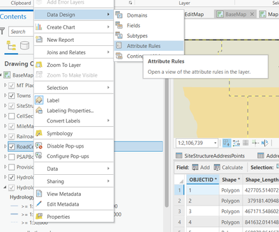

CochranBob
In ArcGIS Pro. Right click on roads centerline layer >> data design>>Attribute Rules. It is the split lines attribute rule.
