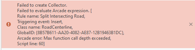

After updating to ArcGIS Pro 2.9.2 the the Split Intersecting Roads Attribute Rule no longer functions. It seems something was put in place to stop the iteration through split roads. When creating a new intersecting road I get the error message shown. the cut function. Anyone else having this problem?

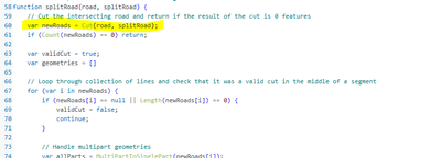

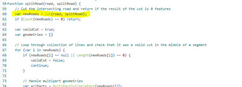

@CochranBob, we were able to find the issue. It appears that the logic for Cut changed at 2.9 and rather than returning an empty array when the feature was not cut, it is returning 1 feature, the original geometry. So it is a fairly easy fix, on line 61 rather than checking if their are 0 features in the array, check if there are less than 2 features. See the screenshot below.

Where do we find the script to update. I'm on 3.0 but it doesn't seem to be fixed in the upgrade.
CochranBob
You have to manually change it. The basic functionality of the arcade 'cut' function changed after the Address Management Solution was released. In Chris's response above he has the code line highlighted and edited where the change is needed to fix this problem. I would not expect this to be fixed until ESRI releases a new version of the Address Management solution accounting for the change in Arcade functionality, but you can fix it yourself based on his response.
